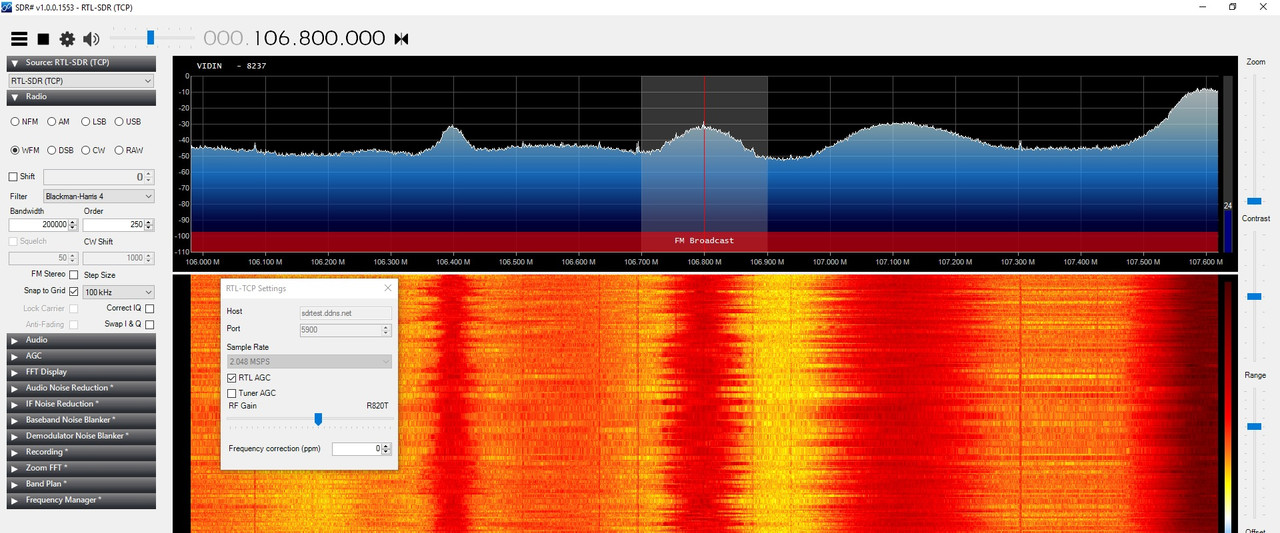

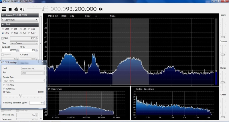

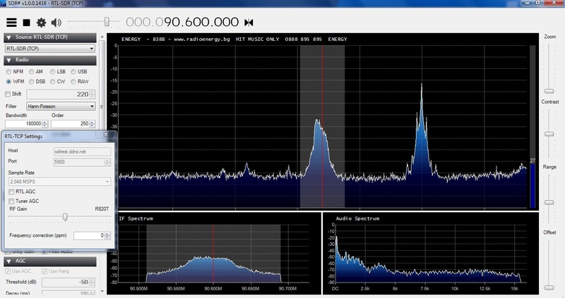

@ RADIOTO
Please ceck connect with 'Sample Rate' 1024 MSPS, in this mode you see more band width.
Sample Rate 2048 MSPS
