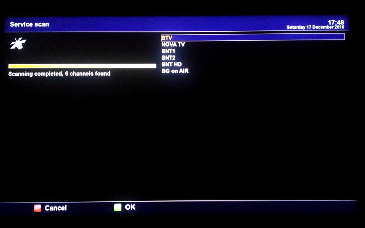

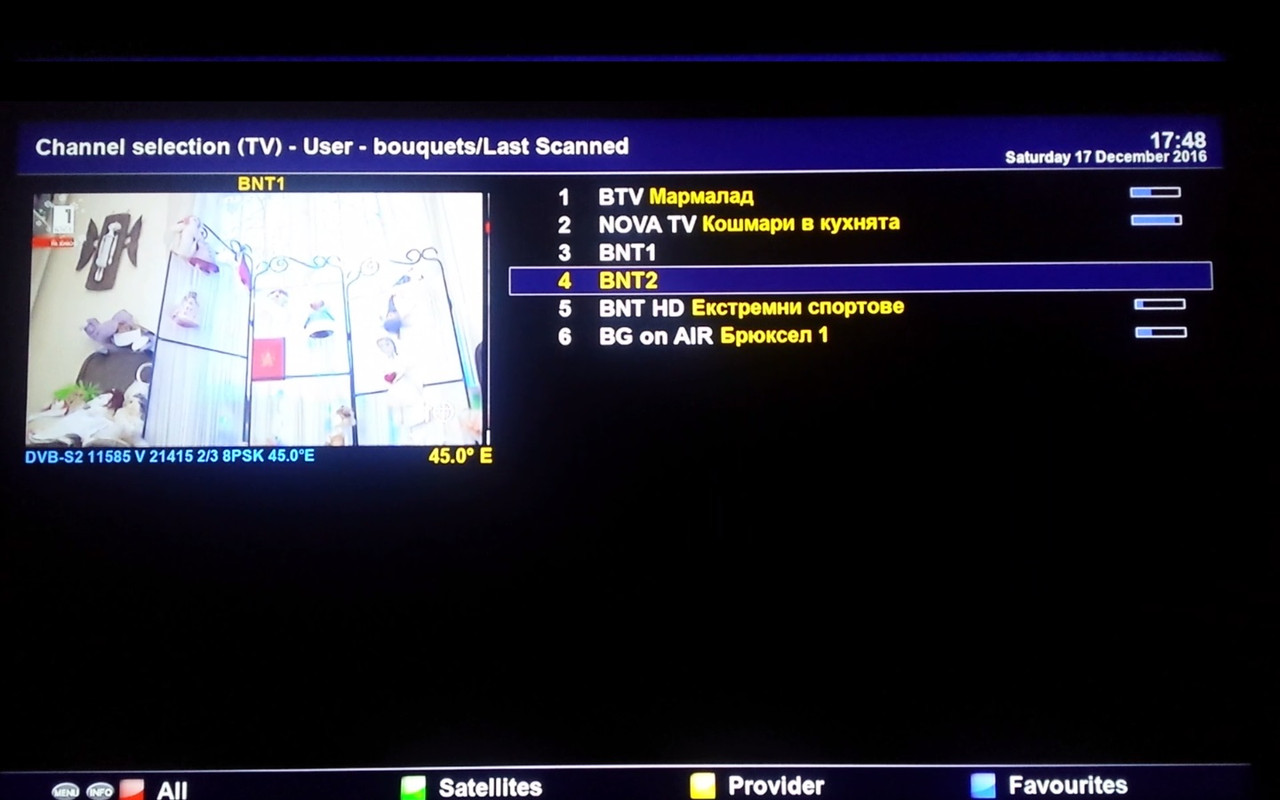

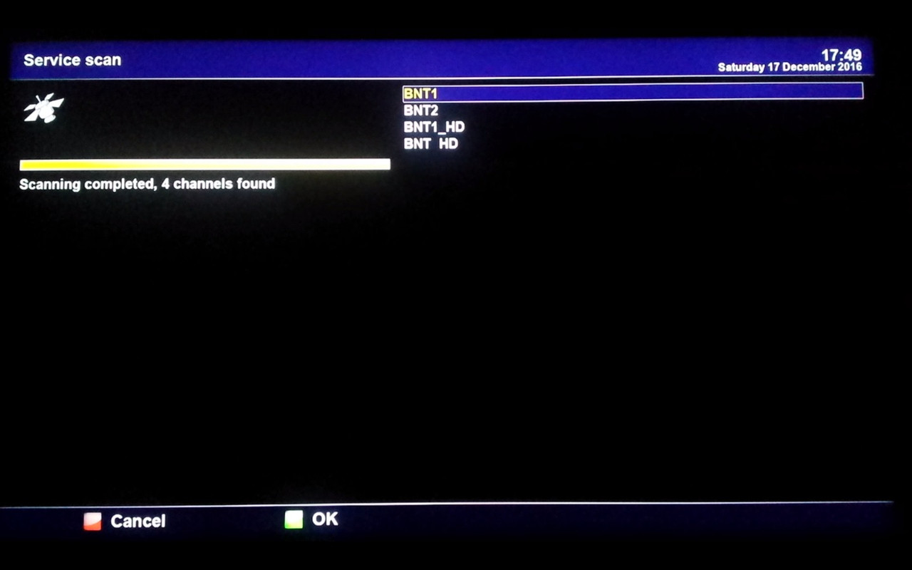

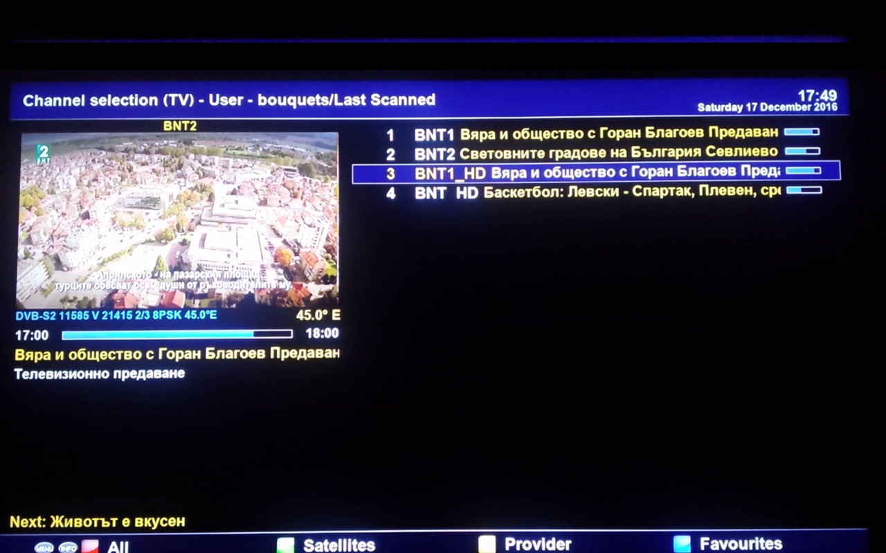

Мнение от marsel90 » съб дек 17, 2016 4:16 pm
Multistream 3 - NURTS Bulgaria
Multistream 4 - First Digital
Receiver Amiko Alien 8900SHD and enigma2 software
