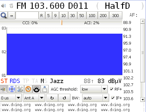

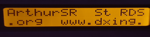

Open λ/2 dipole 150 cm - my project - very resonant to reception 87.5-100 MHz (better than a factory made antenna)
Two al. tubes 91 cm long (reflector of old VHF Yagi antenna) diameter ∅ 8 mm and distribution box for electrical
installations with 6 entries measuring 8x8 cm.
http://www.metalka-majur.com/en/article ... a-6-uvoda/
The contacts for the 75 ohm coax are located at 77-78 cm in length and the distance between the two poles are 50 mm.
For fixing the pipes used screws m 4x4 + nuts.Parts of the old log periodic antenna were used as the antenna carrier (70 cm).
For other details about the realization of the antenna,feel free to ask...
